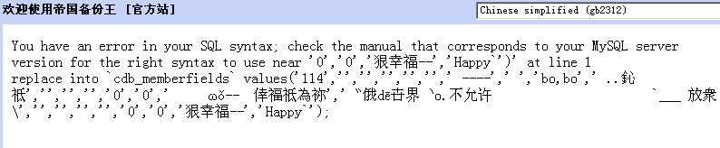

[求助]恢复时候出现错误You have an error in your SQL syntax
  恢复到一般时候出现错误,错误内容请看截图。。

我也碰到过,刚碰的,我显示如下:
You have an error in your SQL syntax; check the manual that corresponds to your MySQL server version for the right syntax to use near '','5656565','2009-06-13 21:11:01','5656565','','1','117.87.246.70','0','0','')' at line 1
replace into `***_enewsgbook` values('3','縗\\\',',1,1,1,(select concat(username,0x5f,password,0x5f,rnd) from ***_enewsuser wher','5656565','2009-06-13 21:11:01','5656565','','1','117.87.246.70','0','0','');
我是新从首页上下载的,应该不存在补丁方面的问题吧,请高手指点一下.

特殊汉字引起的,修改备份的文件,把上面的多余的\删除,然后保存文件,重新恢复

我也遇到相同问题,请高手帮忙:
You have an error in your SQL syntax; check the manual that corresponds to your MySQL server version for the right syntax to use near '','','2009-07-10 17:57:02','系邮箱:','','1','116.23.254.149','0','0','')' at line 1
replace into `***_enewsgbook` values('1','縗\',',1,1,1,(select concat(username,0x5f,password,0x5f,rnd) from ***_enewsuser wher','','2009-07-10 17:57:02','系邮箱:','','1','116.23.254.149','0','0','');
怎么修改错误?

用2010版
